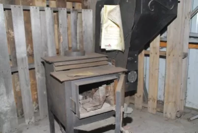

Stove for sale on Craigslist
Pictures like these are far too common here, usually the folks that are screaming how bad our units are SMH
Hes used 4 inch pipe its possible the exhaust goes up outside above the window. Other then the hooky looking window setup which may be ok I dont see anything else wrong.
How about a two piece hearth pad (patio slabs), with what appears to be about 3 to 4 inches in front of the stove? Hard to tell by the pics, but I would bet minimum distances to combustibles are not code, and there is no way in hell that that piece of particle board in the window is allowed.
