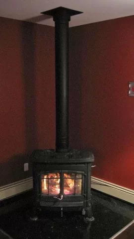

Hey guys-
After a couple weeks of reading and research my job is complete.
I recently bought a used stove that was used for 1 season, a Bennington. After many mixed reviews I was nervous of preformance...
Next was the hearth; ceramic board with the perfect r rating and then a slab of granite on top gave my stove a place to sit.
A trip to Lowes, 997 dollars worth of pipe, and 3 hours later it had a chimney. A straight shot out, double wall pipe to the framed in ceiling box, and adapter to 12 feet of insulated pipe. A total length of 14 feet. I even was able to take $575 worth of stove pipe back.
I started our first fire and after 15 minutes, the box temp was up and a good fire rolling. After an hour our house temp was a scorching 85 degrees. Damn!
With this super hot wood fire, why do I see little to no smoke out the chimney? And when I went to inspect all my work in the attic and roof, I hardly smelt any smoke out the stack? Is this because the efficiency is good? Is the secondary burn taking care of the "smokey" exhaust?
Thanks for the help again,
Jason

Today's EPA certified stoves are designed to burn the smoke in the fire box before it can exit the chimney. With properly seasoned wood, this can result in about a 90% reduction in particulate matter exiting the chimney.
knie, that's a nice looking install--when you have a moment, take another pic from a little further away and better lighting. I'm always looking for ideas!
S
Beautiful install and welcome to the forum. A modern stove with a straight insulated pipe and dry wood burns very clean. You may see some smoke on reloads but otherwise won't see smoke coming out of the stack when using dry wood.
Ja, like he said.
Nice install!
Very nice looking stove and clean installation too.. How did you make out buying a 1 yr. old stove vs. a brand new one?
Ray
Good job on the install. Looks great. Sounds like you are doing everything right.
Yeah, I'm always amazed to walk outside and not see any smoke coming out the stack.
Thanks for the compliments. My boss has 6 chords of wood that he is cycling through so good seasoned wood is easy to come by right now...
As for buying a used stove, I found it on craigslist. The guy that bought new had an 8 inch stack in his house prior. The dealer that he bough the Bennington from said that it could go from a 6 to 8 inch stack. He tried it, with about a 45 (+/-) foot chimney. He said it tore through wood. So, he decided to sell for about a 60% price reduction. Everything is is perfect condition, including seals that look brand new yet.
Like I mentioned before, is it normal for the stove to get up to operating temp before you start seeing secondary flames and even a good stable fire? It would appear that I needed the ash pan door open for about ten minutes. If I tried to shut it before, the flame would die down and then almost look like it went out. But once it fired long enough, I could close the door and then everything picked up and went.
Jason
Looks stunning. Pretty stove.
