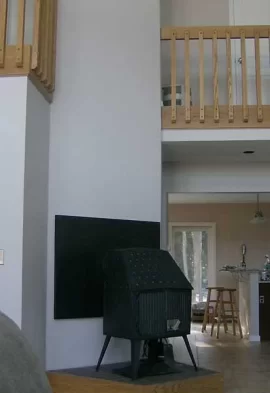

When we built the house two years ago we installed our current (old)wood stove with metalbestos pipe up through to the roof. IT runs from the roof down through to our basement with a cleanout. We were looking at the Morso 5660 wood burning insert and then installing it using the current pipe and build a surround where the woodstove is now. Ive tried attaching a picture but the picture size is too large and i have no idea how to fix that

I am going to try to upload this picture to give everyone a better idea of what i am looking at

I'd put a big free-standing stove there to heat that big room. Doesn't look like an insert is what you're looking for.
So if I have an eight inch metalbestos stove pipe up through the ceiling I cant build a surround and use an insert??? I thought I would just be able to use a 6 inch collar to the eight inch chimney pipe to hook into the chimney. Then install the insert with a surround. Boy this is getting involved.....

Your space does look ideal for a free standing stove. There are some really nice looking ones out there. I almost got the Hearthstone Phoenix this winter but opted for the Jotul 550 because my space just wasn't set up for a free standing stove.
Show your wife some of the soapstone stoves. I think they are really pretty and look almost like furniture rather than a stove.
Jotul has very nice looking free standing stoves too.

No, an insert is an insert. It has one purpose, to be INSERTED into another fireplace. You don't have a fireplace to put one in.
If you want to put a built-in fireplace there and build a surround around it you need a ZC EPA fireplace and I linked to one in another post above.

law.... he is right, going by that pic you need a zc PLUS it would be much more cost effective to go with a stove.. unless you do a gas insert
look for a nice stove... hearthstone , pacific energy check out the gallery for ideas!
