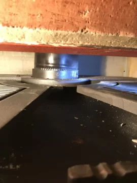

A block-off plate in the damper area will help a lot with keeping the heat in the room. I'd consider it a necessity for this installation. With a blower the heating should be ok.View attachment 228082

Really worried that most of the heat is going to escape up the chimney and it won’t do a good job heating the house. I think I may have made a mistake here...

If its a tight fit with no movement then you will need to loosen the anchor cap on top of the chimney and pull up a little.
Unfortunatly blockoff plates are not required by code or manufacturers so they really are not standatd practice at all. Things like that are the reason we will almost always get beat on price. But the cheaper guys simply arent doing the same job we doAhhh heck no. I don’t do heights.
Even with WD40 and a strap wrench I can’t get any more movement out of the sucker.
