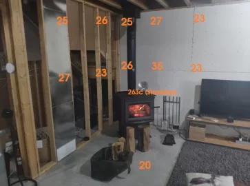

- Walls surrounding stove are in the image, all temps taken with a IR gun at 1foot distance

I do also think the uninsulated slab may be sucking heat out of the stove room which makes it less effective at heating the other rooms. Your radon kit may make it worse by drawing outside air under the slab. So putting down an insulated floor on top of it would not be a bad idea if you have the headroom to do that. Have you checked the floor temperature in that room?
Edit: now I see the picture. 20C is not bad for a floor temp. I'd be interested in the floor temp in other parts of the room though.
