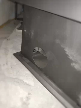

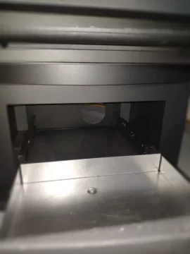

Page 39 in the manual lists the 111KT as optional for the stove, however they omit installation images in the manual.
I have attached photos as requested, the installer did mention there would be a air trap installed with it.

To follow up on the air kit.
The only documentation I could find on the official kit is as follows:
Restrictions for the Outside Fresh Air Kit:
  • Do not draw outside air from garage spaces
  • Do not exhaust products of gasoline engines are hazardous
  • Do not install outside air ducts such that the air may be drawn from attic spaces, basements, or above the roofing where other heating appliances or fans and chimneys exhaust or utilize air
  • Air must always be drawn from outside
It does not specify a max length, if a U trap is permitted or not, but the description seems to indicate that it hooks up to the stove:
"The Outside Air Kit comes along with a 4' insulated flex pipe, the hood to prevent leaks and animal intrusion, and two clamps for the hood and the stove."

The OAK is connected to the base of the stove not direct to the firebox as per the instructions for my S20.
Being in the basement we run the OAK upwards, the fireplace installer had no issue with it as there should not be a backdraft into the OAK as it is not air tight.
I tested the OAK and found littler air flow when the stove is not in use, only when the stove air is shut down then you can feel the air pulling from the source under the stove not from the front. The advantage is then the air is coming from under the firebrick where the ash drawer is.
See below from the manual, pre OAK the air was drawn in from the room (red circle) this is the warm air we had just heated with being sucked up the chimeny.
The yellow path is air from the OAK, it is drawn throught the bottom of the stove and uses outside air.

The OAK should only be connected to the pedestal of the stove not to the firebox itself. So to satisfy the worry of backdraft inside the pedestal is a open area with the ash tray, the front door, and all of these have vent holes as well. I am by no means a fireplace isntaller I leaned heavily on the manual and what the fireplace installers had told us to do. I dont think they would have installed the OAK in the basement if it would have been an issue and I see no mention of there being a requirement of it having to run down or vertical only on my specific wood stove. Again the oak is NOT air tight to the stove.
