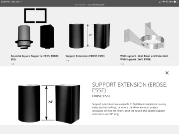

I really am thinking about adding that extension and reworking the pipe though. Seems pretty simple. would I have to remove the chimney that goes through the roof to put on the extension?
Seems like a much easier option than moving the beam. After a few weeks I don't think you'd notice the difference. The focal point is the stove and wall, not what is happening up behind a beam.

Is this the extension?
