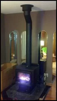

Greetings. What brand stove pipe is this and how tall is the total flue? Triple-wall usually is not used to connect the stove. Can you post a shot of the setup?
[Hearth.com] Stove pipe damper
Not to sure on the pipe length. Best guess is 12-16 Ft. See picture for in house setup.
Ok, that looks like double-wall pipe connecting to the triple-wall at the ceiling. 16 ft of pipe shouldn't be creating a draft issue. I'm wondering if you have an air leak. One thing to check is the ash dump door. It's easy to get a chunk of charcoal stuck in it. That will prevent it from closing tightly. Also check the door gasket with the dollar bill test the next time the stove is cool.
