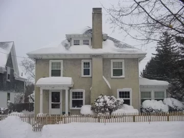

The stainless liner is a 12 foot stub. Then another roughly 20 feet to the top. This is an old four square colonial house with a walk up attic. The chimney is about as tall as the peak of the roof. (picture attached). Not sure of the size of the tiles, but when the chimney sweep comes I can ask him. What should I know about the size of the tiles? Also, what is a damper block off plate? Do you mean a metal plate where the fireplace damper used to be. Yes. We bought a kit and installed it. We removed the fireplace damper and installed this plate and the pipe goes through the plate. Exterior chimney.

Beautiful house, but I wouldn't run the stove without a full liner in the exterior chimney. What I suspect is happening is that as the wood gases leave the liner stub and hit that cold chimney they are condensing and accumulating creosote. If the clay flue liner is larger, say 8x12, the gases are going to slow down and cool quickly. This has of potential for future chimney fires. I'd get it cleaned, and a full, insulated liner put in. That will significantly improve safety and performance. If the wood is good, it should greatly reduce the chimney fire risk.
