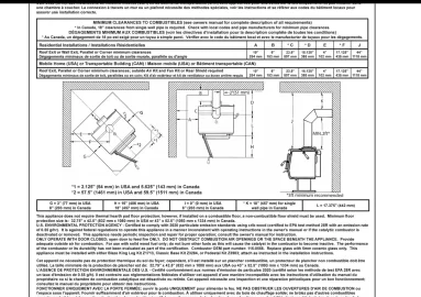

I'm in a little of a dilemma here.
Long story short I'm replacing an old stove that was cracked and leaking that came with the house with a BK Princess 32.
My issues is that the old stove was a rear exit and then rised to a masonry wall exit.
Now the princess 32 is top exit and is really close to the wall exit (pictured).
The masonry chimney will have a smooth wall liner that runs up 19ft.
Location U.S NJ
Is this to close?
Tyia!

Bet $ you will be really disappointed with the smoke spillage when initially starting up.
The Princess experience I have with a similar install flat out stinks!
Not recommended from actual experience.
Use black double wall and make to ne hole as high as possible allowing for pipe clearance.
