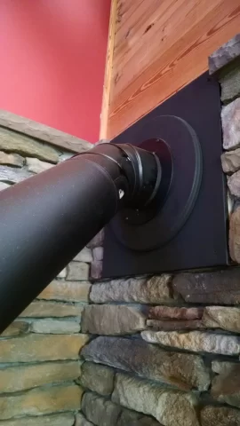

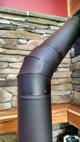

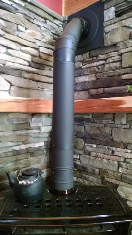

You smoke pipe is backwards - the male ends are suppose to point down to the stove so if you get creosote liquid, it can drain back into the stove and not into your house. You may have some drainage going on right now and its smoking off into your living space, let the stove cool off and flip everything around, it will be easy.
looks like double wall, thats the way it is...
I think that's single wall, the adjustable elbow gives it away, correct me it I'm wrong but double wall you can only get 45 deg elbows, judging the pic it looks like single wall due to the distance between end to end, but I could be wrong, and have been wrong in the past
I've got Ultra Black double wall and the joints come in 15, 30 & 45.
