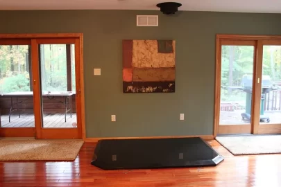

Hey all. I finished my hearth, got the stove in place and I'm trying to figure out where the stove pipe/chimney will be run. It will be 6" pipe, and where it comes thru the ceiling now, the center of that pipe is 1.5" from a joist. So my options are to move the stove (very little wiggle room here because of clearance to combustibles), offset the stove pipe using elbows (girlfriend isn't thrilled about this one for aesthetic purposes, but I think this is my best bet), or cut/sister up joists in the attic.
Ideally the pipe should come thru the ceiling directly between the joists to maintain clearance in the attic space. So I'd have to move the centerline of the pipe 5.5". Any suggestions on combinations of elbow/pipe lengths to accomplish this with as little draft issues as possible? Anything I'm overlooking? Amy insight would be greatly appreciated.

Will the Equinox be vented straight up? It looked like the support box was quite off-center on the wall space and hearth.
I'm thinking the stove might be installed without it's back towards the wall?

I’m thinking the stove might be installed without it’s back towards the wall?
No

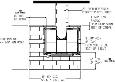

This layout from the manual is minimum hearth requirements. It's a little misleading at first glance as you don't have to have the stove in the right corner but to have the stove centered you would have to make the pad larger on the right side the same as the left. It would have to be 63" wide to have the stove centered.
I made the hearth 80" wide so if it just doesn't look right I can still move the stove and put a joggle in the stove pipe. I went with function over form, working with what I had. I also made the chimney higher than the minimum... doesn't look that great sticking way up there but I wanted to ensure optimum draft. So I ended up with the optimum install. A straight up chimney. There are things you can do with decorating that takes advantage of asymmetry and gives it a "meant to be" look.
