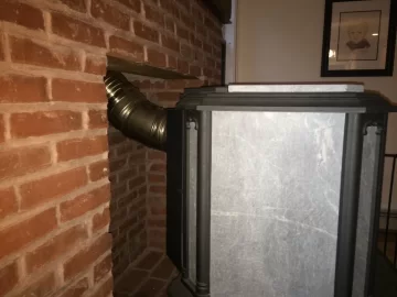

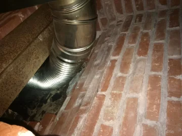

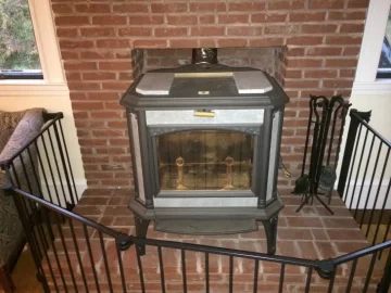

This is the current setup. The stovepipe that I'm looking to get will have a longer vertical run and hopefully get the flexible liner out of site. This way I could go with painted stainless making the wife happy without compromising on quality of material. Thoughts?

we do it all the time just get the paint made for stailess stove pipe and it will work well
