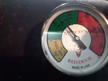

I have used a simple magnetic stove pipe thermometer for a couple years and noticed a probe type at the store.
I've wanted one for some time and had the extra money so, bought and installed.
I've read that the internal pipe temp, will normally be around twice as hot as an exterior reading but, I must say I was kind of shocked.
I placed the magnetic close to the probe and the probe was showing me to be on the verge of the over fire zone while the magnetic was still 50 degrees below the optimal range!
That seems kind of dangerous to me?I'm certain the probe is more accurate and i would be WELL into the over fire range before the magnetic showed me in the optimum range!

These are single wall readings.
The probe shows 550 to be last temp before going into the danger zone.
The magnetic is reading 230, 250 being the start of the optimum burn range.

A probe thermometer is designed for use on double wall stove pipe only. It will give false readings on single-wall pipe and read too high.

Not trying get TOO technical but, can you tell me why the probe gives a false reading on single wall? Is it because the single wall radiates more heat and the probe is picking that up as well as the internal flue temp?

Sorry if I seemed to imply over firing at 550. Mine shows 550 being the last temp before going into the red, which shows to be too hot.

Yes, a probe thermometer is calibrated taking into account the extra shielding provided by the outer layer of the double-wall pipe.

On start up or with a fresh load of wood the temp may go to 600+. That is when the air should be closed down. Condar makes two probe thermometers. One has a scale that is this conservative. The other has a higher range. Neither is truly right as the high temp (red zone) depends on the stage of the burn and the stove itself. Some run with hot flue temps, others run on the cool side. Regardless, these are made for double-wall stove pipe only.
