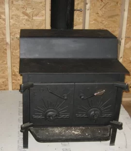

I have an older Kodiak Wood Stove at camp. Here is a picture of it. It uses an 8" pipe. My question is can I run 8" single wall pipe straight up inside the camp and when it reaches the insulated pipe can it be reduced down to 6" insulated pipe that goes through the roof? Thanks Pete

Your stove will draft much better with 8" all the way.

I have always thought that it is OK to run a 6 inch pipe in to an 8 inch but that it is NOT OK to reduce an 8 inch down to 6 inch. Thats my uneducated opinion but I do feel the stove was made with the 8 inch for a reason so the fire box might require the greater draft then a 6 inch will allow.

I guess you could do any thing you want . I don't think it would cause a danger ,but the stove would not have as much draft as it should and wont burn 100% My sister has a vigilant and had a 8" to6" but she had a oval outlet on the stove so i had a metal guy make a part that went from the VC oval to 6 " round The part was about 12" long. I like to clean my flue from inside so i like to run my brush up on straight pipe. We changed the flue to 8" all the way up, the stove burns much better. John
Some people will probably say it isn't to code but we used to do that all the time. We would use two long tapered reducers that gradually reduced 8 to 7 and then 7 to 6. The large 8 inch pipe slows the rise to scavenge more heat through the stove pipe. As it rises and cools, the taper accellerates the flow. If there is a lot of cooling, reducing the size sooner speeds the flow out of the chimney so that it doesn't have as much "hang time" inside the chimney, improving draft.

I installed it in the camp I'm building as I described. It drafted fine and I can leave the doors open with no smoke. The problem I had was that when I cut back on the air for over night the next morning there was creosote running down the pipe on the outside of it. I don't know if the reduction in size caused this. Pete
Unseasoned wood caused the creosote.

There is of course the fact that building & other codes prohibit a flu from being reduced at any point beyond the flu collar and the flu must be equal to or larger than the flu collar of the stove.
Without failure there are lots of people that love to say "Codes Schmodes, I know what I'm doing" But the other side of that is not just the municipal code inspectors but the insurance companies that will leap at near light speed to any potential opportunity to deny a claim. If your setup is not up to code & manufacturers specifications for installation then any mishap you may have from a fire to Carbon Monoxide poisoning would not be covered. How much could that possibly cost you?
Then there is the issue of proper function. Your stove was designed and tested to work correctly with an 8" flu. Changing that changes other factors that were not accounted for in the testing that was used to obtain the listed status. As mentioned, reducing the flu will accelerate the draft, which will also accelerate the draw of combustion air through the intakes, which can allow the stove to be overfired well beyond it's design limits. Higher potential maximum temperatures could lead to damage to your stove or a fire. The min. clearance to combustible materials was determined using the draft and max firing rates of an 8" flu. Many people may think "more draft is better", not necessarily... The higher your draft the faster combustion gases are drawn from the stove (combustion chamber) draw them out too quickly and you may be drawing out lots of unburned combustion gases, preventing secondary combustions and actually increasing creosote buildup by running tons of dirty exhaust through your flu... Not to mention all the lost BTU's (cardinal sin...) and excess smoke/pollution. Also, change the amount of air being drawn through the system and you change the combustion air requirements of the structure. Will the building house sufficient combustion air supply for a system that is now running in overdrive? If not it will choke the combustion, cause incomplete burn, create more Carbon Monoxide, more creosote, maybe backdrafting. In short, it's not just a pipe your messing with, it's an entire system with a lot of variables. An engineer was paid a lot of money and took a lot of time to make sure all the variables were going to play nice together and now your going to change one of them....
Now for as much as this sounds like the sky is falling, you may be able to go years, even decades with no problems at all, but for the potential negative outcomes is it really worth not just replacing the 6 inch flu with the correct 8 inch it was designs to work correctly with and being done with it?
