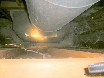

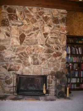

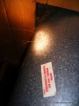

Three pics from today's inspection activity...
Front of fire place, view of chimney and firebox from the cold part of the attic (no insulation or air block.)
Amusing sticker on the chimney pipe, about clearances. Happened to be right at the point where it is in contact with a wooden plank...
  • [Hearth.com] Stove Recommendation:  Large, drafty house; mild climate: PICs added
fireplace pipe is not installed correctly. In the 3rd pic, It is passing thru a wood floor with no firestop and wood right up next to it (while the sticker clearly visible on the pipe is stating 2" clearance to combustibles!) Since its a prefab fireplace, I would not venture trying to put a woodburning insert into it!
Am I wrong or does this look like a cheap single wall pipe, not a HT 2100 rated Chimey?
The house inspector should have pointed these things out my friend. I you intend on bidding on this house you should point it out to the seller and knock off a few grands of the asking price. Personally, I would rip that sucker out of there and buy myself the biggest EPA ZC I could find, Install the convection Kit to get heat in that room and a forced air kit to bring heat in your furnace duct work.
It's a shame there are so many of such installation in North America where all the expense went into the making the fireplace facing look great (stone works etc...) but then the builder installs the cheapest available wood or gas ZC tin box they could find in the market.

Am I wrong or does this look like a cheap single wall pipe, not a HT 2100 rated Chimey?....
Yep, cheap single wall pipe. I was kind of surprised, since most of the rest of the house was a little upscale for the decade it was built in (1980).

Are you sure it is single-wall? I doubt it would have that 2" clearance label on it if it was. It may be air cooled pipe which would be at least double-wall. Not saying it is properly installed, it isn't. But be sure to identify it correctly if asking for a price adjustment.
Franks said:
Good lord dont build a fire in that thing.
+1 Do I see the wood studs starting to char where the pipe touches it?
So get an NFI certified sweep or installer to write a report on this installation. From what we've seen you have a couple of choices with that fireplace. 1) Resign yourself this is just a nice stone wall with a black hole at the bottom. Dont start a fire in there. 2) I'm not a gas guy but you may be able to run a vented or ventless gas log set in there to make things look prettier. Wont get any heat from that however. 3) This is the most expensive option: Tear the works down and do it right. Unfortunately it will mean breaking down some of the stone work and you will have to patch it up after.
