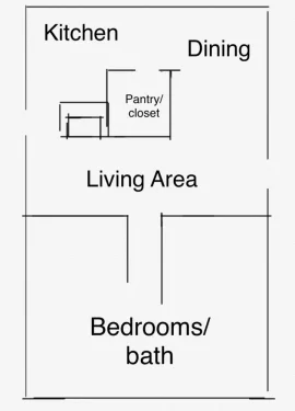

Floor plan, please.... rough drawn is fine :)

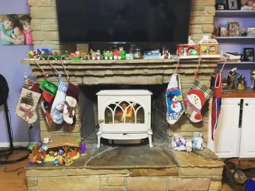

I went with stove mounted inside purely for looks. No need for floor protection. It heats ok. Could be better and needs a blower. my height was 29 H x 42w I think Enamel finish was extra cost. Call it $5k to have installed.
Evan
I like the way yours looks. Still trying to decide on that part as well. Wife keeps changing her mind on it. :confused: Thank you for sharing!

This is a rudimentary floor layout. It’s not ideal but what I have to contend with. I tore down many walls to get the open floor plan in the “Living Room” Fireplace isn’t where I’d want it but it is what it is.
I didn’t try to draw the bedrooms etc since it’s just a long hallway with them off shooting right and left until the master straight down the hall.

That looks like a nice open space for the main living area. A good-sized insert with a blower to move air should really help. It’s nice that the chimney is interior.
Reactions: trey g and Dix
Yeah, I think you could get a nice loop of air with all that open space.
Reactions: trey g
