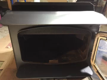

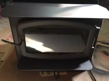

As I posted a while ago, our Kent Tile Fire has a warped baffle. I loved that stove. I was looking around for a replacement and found a 2003 Avalon Rainier 945 insert in excellent condition. Seller asked $375, I paid $267. Stove came without blower.

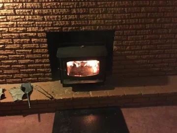

After brushing, cleaning and painting, I installed it in our masonry fireplace. Extended install, no surround panels. Sheet metal block-off plate with Roxul on top of it.

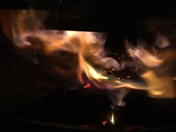

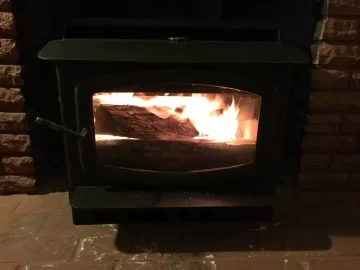

Burning during the day a mix of pine and oak, both levels of the house are maintained at 76 F (dining room 72 F) with an outside temperature of mid 40's. I have not yet decided to purchase the original (overpriced) blower, so I use a table fan on the floor in front of the stove to blow cool air in. Stove top temp is 530 F, connector stove to liner is 410 F.
Last night I filled it full with red/white oak at 1 AM and at 11 AM this morning I had enough coals to restart a fire. Outside temperature was around high 30's to 40 during the night. I am curious how long the overnight burn will be when it freezes.
However, considering the 1.9 cubic feet firebox, very impressive.
What I like about the stove is that it is very easy to operate, the air wash is excellent and a relatively large glass in the door.
When the stove is hot, I notice a slight humming sound with air open or closed. Not very disturbing. Sound goes away when I open the door.
