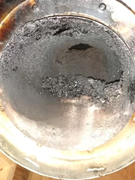

Yup, air going out. Here was the issue...
[Hearth.com] Stove seems to be not getting air
That's pretty bad. Clean more frequently and get dry wood for next season.
Reactions: Diabel and bholler
By the looks of the pic this is inside the house. I'd be curious of the upper chimney looks like. That will definitely impact draft.
