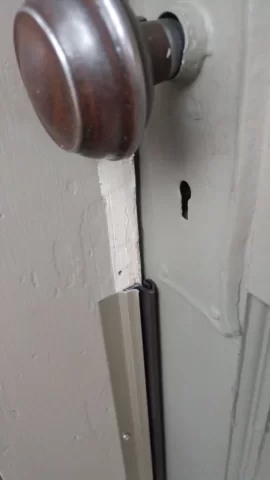

I'm working on our door weatherstripping now. If your place is older, you may need the screw-down metal flange as in this pic. If you have newer doors, they may have a kerf sawed into the frame for a fin on the other version of this strip. I have that on the next door I'll work on. It presently has a similar V-strip design, but a cheaper version, foam covered with a plastic jacket. I went ahead and got the better rubber stuff..
