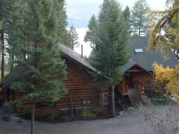

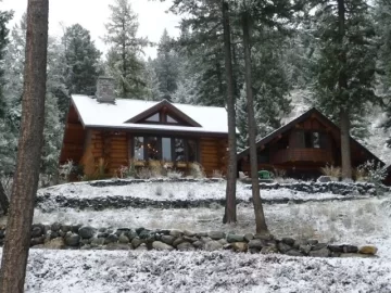

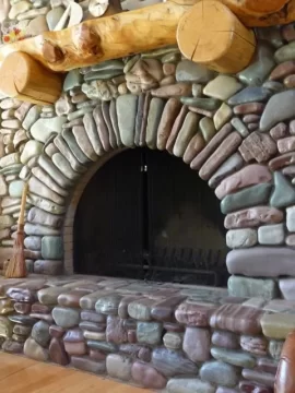

I attached 2 photos 1 showing the fireplace mouth-any aesthetic views regarding stove choice welcomed- the other shows how the house is separated, the room in question is on the left

How would you install a stove? Inside the fireplace? I think you might be better off with an insert as all that masonry will absorb a lot of heat from a stove. But the insert folks can comment on that.

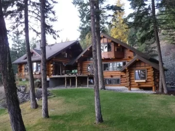

AFB- Thanks for the compliments- will see if I do have more pics and post them up- there is a ceiling fan in the great room- seems to do a pretty good job-- as far as heat load- though the logs seem to do a pretty good job-we have some leaky spots we need to address and we want to insulate the walls of the crawl space underneath (right now its just under floor)
Solar- great to hear you actually get some heat movement out of a space like this- are you blowing cold in or hot out? we considered an insert but could not find an insert/surround combo we liked with the opening- plus we are trying to avoid a blower. Realize it might not be the most efficient but visual appeal has to trump ultimate efficiency. Heat right now is electric baseboard and electric forced air in the great room- not as bad as it might seem-right now we pay 5 cents a kwh. Eventual plan is a ground source heat pump-with rebates from feds,state and our coop works out to about 50% off these days.

Wow, you live in the good place. Ceiling fans in the great room and a fan on the floor blowing cold air towards the great room. Blowing hot air down the hall was ineffective at best.
With a big room and ceiling fans, you should be able to avoid the blower. But, I think you will want the biggest stove you can buy/fit especially if you plan to put it in the fireplace as opposed to in front of it.
kind of my thoughts as well- the stove would be part in, part on the hearth I think.
