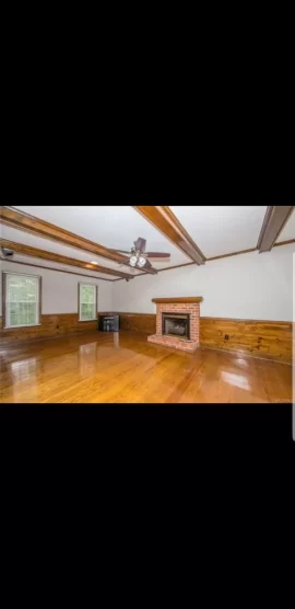

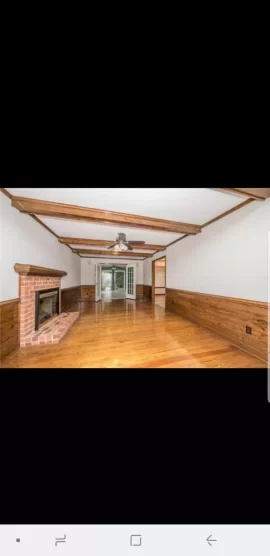

The pictures on here show a huge variation in appearance of the size of the room. If it's as narrow as it appears in the one I don't think I'd like the stove sticking off the front of the hearth extension but if it's as wide as it appears in the other you could probably put a baby grand piano in front of the stove and still have room to pull a car in there.

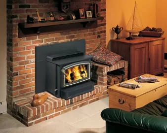

  • [Hearth.com] Stove suggestions
Inserts have different designs. Some are more radiant than others and some convect naturally than others. In general a flush insert will be at the low end of the scale for these attributes and an insert that projects out onto the hearth will do better. There are many choices but not all may fit. This will depend on the dimensions of the fireplace.

I see how the two pictures make the room different! I just took measurements and it's 12' by 25' a big rectangle. Do inserts like the hearth heater heat well through radiation only as well as convection? Like best of both worlds? Also would a insert that sticks out 8-10 inches radiate heat well at all? Thanks for the input guys

12’ from the wall to the opening of the fireplace? That’s pretty narrow for putting a freestander in front.

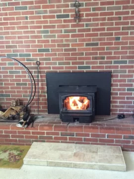

I’ll let others chime in for stove suggestions, but in answer to your insert question, yes, non-flush inserts do radiate as well.

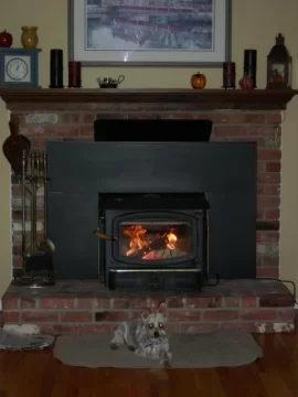

Reactions: MAD MARK
Y'all definitely have changed my opinion and I appreciate it. I came here as I know the sales reps in the stores don't always know what they're talking about and it shows here, that is why I came here for advise. I appreciate it. I will be going with an insert because personally we don't have all that many power outages and often when we do temps are 30-50 out. I believe in those conditions even a flush mount without its surround would keep our living room tolerable and we can hunker down there. But that is a worst case scenario that I have yet to see. My wood supply is growing. I have been researching and trying to decide the direction I want to go for months now. I have about 1.5 cords of pine I'm finishing splitting and stacking now to season out for next season. I know it's not a lot but its what I have to so far I will be looking at the wood suppliers near me when they have their spring specials on oak and work on scrounging some of my own over the summer to let that get seasoning for the future
