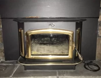

Hi everyone! New poster to the forum but you all have helped educate me quite well. I've found a seller of a Buck Stove Model 91. I'm going to post up a few pictures and I'd like opinions if you'd be willing. The negotiated price on this bad boy is $550 cash. Do you think it's worth it? I'm not sure the year it was made but the front cover of the manual suggests 94 or newer?
The inside photo is what has me concerned. Is the firebox supposed to look like that? Most everything i'm seeing looks less... concerning.
I thank you in advance for any opinions.

That's a great deal, even if it needs a new catalyst. The tarry interior probably means it was run low and slow. Perhaps it was too much for their location?
Do you need an insert this large? It will require an 8" liner. Will it fit your fireplace?

We have a 2100 square foot ranch with very poor insulation (that's another project) and a broken heat pump (also another project.) It was a foreclosure so we got a good deal, but also a lot of challenges to overcome. The fireplace is more than large enough to fit this unit. I have checked measurements.
I'm mostly concerned with what I'm seeing inside that firebox. Is that rust colored stuff normal?
The person selling it has offered everything that currently is used with it - he wants to get back to just a plain old fireplace for some reason or another, so it should come with everything needed to install it properly.

Sounds like a go. If you can inspect it look for any obvious defects like cracked welds, warped parts, light grey or whitish paint around the flue collar. If it looks good this could be a very good deal. The cat may be plugged or damaged but I wouldn't let that be a show stopper.
Cat will cost you a couple hundred dollars but is easy to replace and will last years. As long as that rust is surface, I would not think twice. We have one of the same era and it burns like a champ. Long burn times, huge wood box and it is built well and parts easily purchased and installed.
What would the light gray/white paint indicate? Not too worried about the cat; I was noticing that isn't terribly expensive to replace if required.
It would indicate possible overfiring.

Gotcha. I just did some reading on over-firing indicators and will keep an eye out when we're removing it. It sounds like nobody so far is scared away by this thing so that's encouraging. The seller is pretty far from me so I was definitely interested in getting some other opinions on the photos, as that's all I have to go on right now.

You could burn the paint off of that beast and the house down around it and it would come out just needing a paint job.
Not sure what I'm seeing in the 4th pic. Is that the airwash channel with no screen on it? Where is the cat heat shield (below airwash screen in my pic?) I don't see any firebricks in the stove...older model that didn't have them? Mine is an '08. I don't know....I would take a real close look at that stove.
I'm not sure either. I have a friend I asked about the fire bricks, and he said his (same model) is all metal inside with a brick bottom. I saw that photo online too and was concerned until I asked my buddy about it. As far as the other differences maybe just model differences over the years? Any other thoughts?
I don't know how talkative the seller is, but if you can get him/her to divulge more about the reasons for wanting to sell it that would be good. Wanting to go back to a regular fireplace suggests one of two things... either something is wrong with the stove or the owner doesn't know how to use it. Of course there could be other, more personalized reasons, but I would definitely want to know more about the current owner's dissatisfaction.
I don't know if you'll be able to see the combustor, might have to take off a heat shield to see it. Take a pliers to pull retainer pins on the shield. If cat is crumbled, cry like a baby and get him to take less for it. The combustor (for mine anyway) is like $275.

I did ask a little bit of those types of questions. He's recently purchased the house and the stove was included with it. He says he just wants to find it a good home because they will never use it - maybe afraid of fire? They might want gas logs? I haven't really discussed the exact reason for dumping it other than just not having a desire for a wood burner. The guy seems to be up and up from my assessment of his character though.

I just got rid of a 27000 and bought the 91 (for about 5 times what youre going to pay :) ) with the 27000 the wife would be up adding wood a few times per night. The 91 easily goes all night.. and yes the older ones had No side Bricks- Which equals more available space for wood.....

I'd think you are looking at much less than 900, worst case. I would probably have a cat on hand, in any case....even though the warranty clock starts ticking when you buy it. If it's like mine, you need the gasket that goes between the cast cat housing and the stove top.

You are not factoring in the insulated 8" liner that will be required for this to operate correctly, that right there is going to be $800+ depending on the height of your chimney.
$550 for insert - fixed cost
$800+ for liner - possible cost depending on if this comes with insert and is still usable and long enough for your chimney
$100 for catalyst housing - possible cost if warped
$275 for cat - possible cost if crumbled
Parts for this stove can be found here: (broken link removed to http://www.buckstove.com/partsstore/home.php?cat=130)
Btw, that "seasoned" wood is probably not as seasoned as you would like to think it is unless they kiln dried it. I would recommend buying a moisture meter to test it, these stoves like true dry seasoned wood to operate correctly.

I will inspect the cat when I get there. I'm hesitant to have the seller inspect it for me because he doesn't seem to know a whole lot about the unit and I'd hate for him to damage it in some way accidentally. I'll just take the risk of it needing replacement I suppose.

Good luck. Hope it turns out to be a winner but go in with a skeptical eye. If firebrick is missing or needed ask for $50 off. If new cat needed, $100 off. Be willing to walk away if obvious damage is noted.
