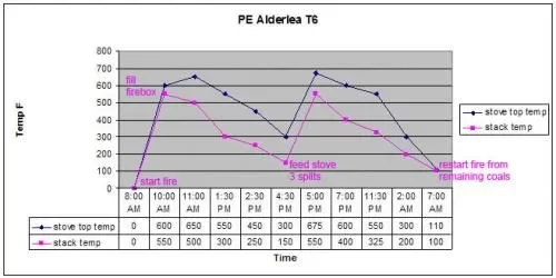

That's how our PE works. After reducing primary air, secondary burn gets going strong. The firebox and stove get hotter, yet the flue temps drop. It's not unusual for us to see 750 stove top and 450 flue temps after feeding a full load in the stove.
  • [Hearth.com] Stove temp increases to 800 ° in the fire Box and flue temp lowers to 300 °
You know you are a Hearth addict when you have performance charts for your stove that you made yourself. I wish I could do that....
I've got a question about that graph. At 10am you have 550 in the flue dropping to 150 over 6.5 hours. At 5pm you have 550 in the flue dropping to 200 over 9 hours. You're gross heat output (stove top) was greater on the second cycle than the first cycle yet the first cycle was full up and the second cycle was just 3 splits. How do you explain that? What are you doing different between these cycles that makes the second one burn less wood over a longer period and still yield a higher BTU/hr figure?

That can't be right. On the first cycle he would have already had coals from the night before (most probably). Then he started a fire at 8:30am. That fire warmed the stove and flue. Then at 10am the pre-heated stove was loaded. With the second cycle, on the other hand, the stove wasn't at operating temperature when it was loaded.

Neither our wood species, nor our wood split size is consistent. Also, the first cycle was a warm up the stove and house cycle. Once the stove is fully up top temp, the EBT seems to work better. This graph mostly illustrates that with reduction of primary air, flue temp go down, while the stove top temp continues to go up. To be really meaningful I would need to plot a graph of several days of burning. Maybe later.

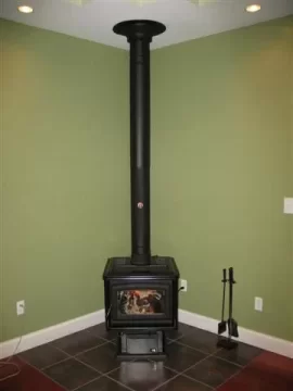

How are you reading those flue temps???? With a probe or surface mount thermo??? Double or single wall if surface mount?? Just curious as my PE spectrum acts the same way but my flue temps are so much higher.
double wall flue, probe thermometer... softwood.
Your chimney isn't very high, is it??? I can't get my flue temps below 600 with the secondary kicked in and air shut all the way down. Actually, my stovetop and flue gas are usually pretty close, most of the time flue is higher...
About 19' tall. But I have a pair of 45's for an offset right above the stove to align with the HT flue. That may be slowing things down a bit. Have you considered adding a flue damper?
Already did, right at the stove connection. I got about 6 1/2' Double wall into a 25' or so HT-103 chimney. I can tell the damper makes a difference but obviously, it's not enough. I only have it open during reloads to suck up the smoke and for 10 minutes or so after I load up. The rest of the time she's completely closed. And no, I've checked and checked and checked and I have no gasket leaks or other air leaks. I hate seeing all that heat escape up the chimney but I don't know what else to do... Here's a pic of my setup.
