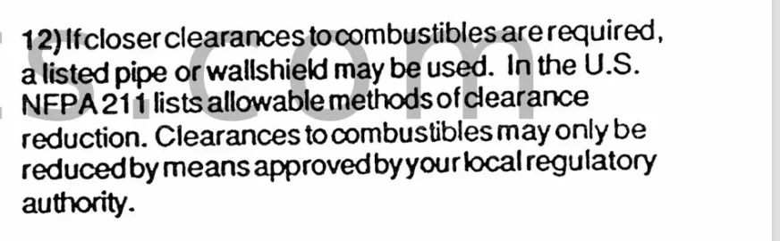

I did find this note in what I believe is the manual dated 1991. The manual talks about mobile home and residential close clearance.
I'm not sure what close clearance means, but it could mean to non-combustibles? You will need all double wall pipe right from the stove and need to re-do your wall to non-combustible with an approved heat shield. I think you have a zip code as location, so you are in the US, not Canada. You will need to check this all out with NFPA 211 and your fire department and insurance. You MIGHT be able to get C at 7.5".
I'm not sure why you mention 36". Probably a typo. In the mean time, you should move you stove back to nameplate.

NFPA 211 clearances were mostly written for unlisted stoves. They don't permit a clearance closer than 12". As noted, if the local inspecting authority is willing to sign off on a closer clearance, then the insurance company may (or may not) accept that. Get everything in writing before proceeding.
