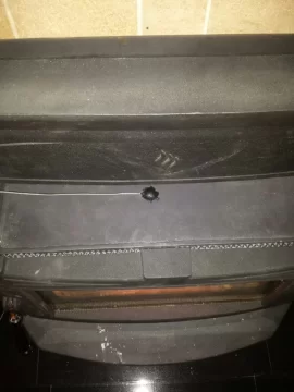

Alas, I think I located the sensor too far forward on the stove top. It seems to be cooler there. I couldn't realistically put it back any farther because it's an insert. Maybe I could, but it'd be harder, and I'd have to scrape the cement off the sensor to relocate, etc.

I think that is on the convective top. If so the temp there is going to be lower. Is there an air gap between that surface and the actual stove top? The Hampton is challenging because of design. I think the convective slots where the heat comes out are notched into the door. If that is correct I'm not sure if the gap is large enough to route the wire above the door and to the actual stove top. Can you post a shot of the door closed and then open?
No, that is not the convective top. The decorative cast shelf has been temporarily removed. That is the top that I've seen glow. :)
Now, where is the best place-close to the flue exit?
That may be as close as you can get without pulling the cast iron surround. If it was glowing at that location the temperature there was over 850º.
It was glowing closer to the flue exit. There's about .5-.75" clearance. I might be able to do it. A horizontal magnet mount would be nice.
So, what do you think? If there was no constrain on access, like, it was a free standing stove, what would be the best location for the representative temperatures you've noted?
