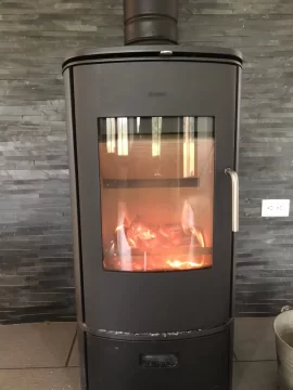

Dear Members. We have installed a Morso 8142 and it’s working out nicely in our home. We are new to wood burning and are loving it. It will long term be only supplemental heat. Right now it is our primary heat until new system is installed.
Question. How do burn most efficiently. The morsoe has a control lever, I have kept it mostly open and feed wood as needed. When I try to lower the air flow it seems like I have to adjust it too often as the flames end up disappearing if I lower airflow too much or if too little it burns nearly the same as full air.
Should I get a thermometer? My stove pipe is double wall, so I’m not sure how to get effective readings. Do I need a probe installed or should I just burn by feel?
Should I just adjust the airflow every 20-30 minutes?

Looks like it could use a few more pieces of wood. With a good fire and more wood you should be able turn down the air in increments once the fire is burning well. Turn it down until the flames get lazy, then wait 5-10 minutes for the flames to regain strength. Then turn it down some more until the flames get lazy again. At this point some billowing flames may start to appear above the wood. This is secondary combustion occurring.
Very pretty stove you got there

You can get an insertion probe for your double wall stove pipe. You just drill a 1/4" hole 18" above the stove and stick in the probe (takes about 1 minute). They usually have a magnet to hold it tight against the stove pipe. It won't leak smoke since the chimney is under negative pressure from the draft.
