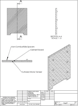

The sheetrock can stay, but the cement board should be space 1" off of the sheetrock using non-combustible spacers like the ceramic ones that are commercially available.
Then attach the stones to that cement board.
Since you're going to be attaching A LOT of weight to the cement board, there is no way you'll be able to have an inch air space along the bottom which is required. You should leave part of it touching the ground.
I'm going to draw a sketch because I know I'm not explaining well.

  • [Hearth.com] stove wall shield

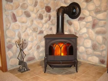

For what it is worth... I installed cultured stone behind my Jotul Castine stove. It was not that hard but it took a lot of time. Make sure that you fasten the cement board real well. You will also have to use metal lath over the cement board in order for the stone to have something to grab on to. I will attach a picture to show my stove and rock.
Mike
Mike
Is that a thermometer on the horizontal pipe near the wall thimble? If so, your not going to get a true accurate reading there.
"Is that a thermometer on the horizontal pipe near the wall thimble? If so, your not going to get a true accurate reading"
Yes it was, but I moved it about 14 inches off the top of the stove. That was one of my learning curves I went through with the new stove. I am slowly catching on the ways of wood burning.
Mike
Mike
We all are :) that setup & the stone looks damn nice BTW!
