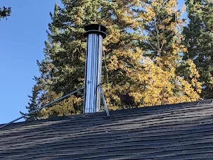

Hi, it is a freestanding woodstove. I don't know if there is a liner, my guess is no. The flue appears to be single wall. I will try to post pics, not sure if that will help. Is it possible something as simple as the insert from inside the stove is not fitting quite right?

Yes, there's no liner in that system. Is there an offset in the attic or does the chimney pipe go straight up?
It looks like the stovepipe goes from 6" to 8" with an increaser. Are there 3 screws per each pipe section joint holding it together? Is the top section secured to the ceiling support box with 3 screws?

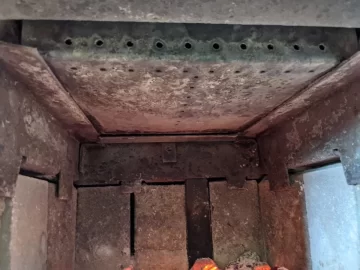

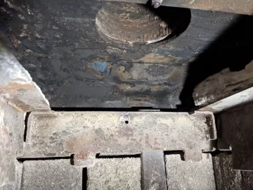

Here are some pics of the inside, looks normal to me, does it to you?
begreen
Mooderator
Staff member
Nov 18, 2005
89,794
South Puget Sound, WA
Yes, the baffle is ok. I suspected you had a PE stove, but wasn't sure. Did the fellow remove the baffle when cleaning? If yes, did he stuff a rag down the secondary tube before sweeping and then put a new gasket on the secondary tube before putting it back in?
Yes he removed the baffle (the thing with the holes on top right?) but struggled with it for a while (wasn't sure how to remove it). When I felt it later, I moved it towards the back of the stove a bit (there was about 2 inches) but that did nothing to reduce the noise. He did not stuff a rag in there for sure. And no gaskets for sure. I've never seen anyone do these things you mention, not even the usual guy (who is an apparent pro) I get yearly. Is there something I could try myself?

OK, it sounds like he messed up in several ways. My guess is that crap went down the secondary tube. Then, there is no gasket for the baffle, but at this point it could be irrelevant if the baffle is not properly seated on the secondary tube feed to the baffle. And the baffle pin is missing.
To understand all the issues, what model stove is this and what year?

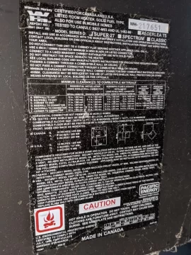

Yikes. I really appreciate your time. I can't find the paperwork for this stove yet (in my stacks) but I will look in the morning. However, one their website this looks like the same model. Mine will likely be older, all I know is I've had it for 5 years, but it was here when I arrived, so would be at least a little older than that. Here is the model, it's the most basic one: https://www.pacificenergy.net/product/vista-le/
MongoMongoson
Feb 6, 2021
173
Wisconsin
There should be a sticker on the back of your stove that gives the specifics. Can you get a picture of that? That would give the year. It's probably not that critical since you know the model and it doesn't look much different inside than my 2020 Summit.

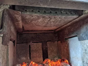

Ok here is a bit of an update, I'll attach a photo of the sticker on the back (model Super 27, manufacture dates lists 2004-2009).
This morning I removed the baffle (after watching youtube videos). I cleaned everything out best I could, inspected the area. I understand now how it should align, but I don't have that alignment Pin anywhere, but I re-installed it so the two holes fit perfect and the baffle is flush with the hole at the back. This creates at least 2 inches of clear space at the front of the stove though, where flames go up and over the baffle (is this ok?), it's either space at the front or space at the back.
Just lit a fire, and good news is: the thermometer is now showing temps as what I would expect it to. Seems like that issue has resolved.
Bad news is, I can still hear the wind-like sound. I wish I could share audio, it is hard to describe and really hard to pinpoint where it's coming from. I'm listening to it now, it just sounds like a fast squirreling sound and is quite subtle but annoying (especially when I'm not sure if this is a safety issue or not). It might be quieter than before or maybe I'm just getting used to it. Attached pic of baffle removed in case that helps.

Yours was made in November of 2008, see the little cutouts on the sticker over the month and year?
Was your baffle not pushed back before? The rectangular tube running up the back of the stove needs to up inside of the rectangular hole on the baffle. So, yes the pin holes need to line up, but you also need to make sure the tube is in the hole. When the baffle is in position, you should not be able to pull it towards you without first lifting it up in the back.
Similarly, you need to lift the back of the baffle when you are installing it to push it back and have it drop onto the tube.
You should have a space at the front, between the glass door and baffle, not at the back.
You will still need that gasket, but it is good to know how to install the baffle correctly before you get the gasket, so you are doing the right thing now.

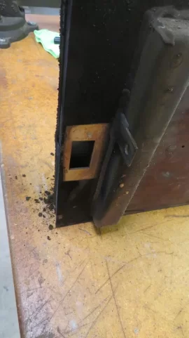

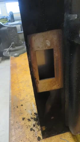

Here are some pictures of the underside of my baffle. You can clearly see where baffle sits on top of the gasket (the clean area around the hole on the baffle). Note that the hole in the gasket is offset from center. The "skinny" portion of the gasket goes towards the back of the stove. I don't have a picture of just my gasket installed in the stove. This is the best I can do for today, but I'm sure now that you have looked at your stove closely what these pictures show you makes sense.
When you ask for your gasket in town, make sure you tell them that you have a 2008. It looks like, from the most recent Vista manual, things have changed and it now has tubes instead of a big stainless steel baffle like your stove has.
