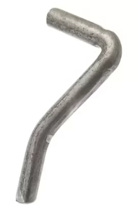

I, too. was wondering if the missing gasket is contributing to the sound now that it is clean.
What pin are you missing? Is it a roll pin?

The pin is about 1/4" thick and Z shaped.

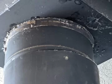

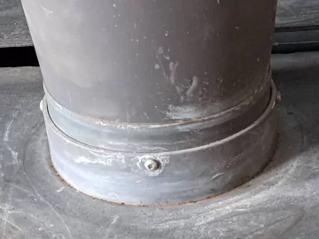

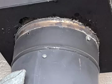

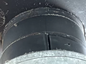

Hello, attached one pic from the base of the stove to the pipe, looks secure with all appropriate bolts. The rest are of the chimney to the base of the ceiling, I see only two bolts there and a number of empty holes (some of the fluff looks like bolts but are not). The guy only removed the chimney cap when on the roof. I was really surprised how little time he spent up there, and I only heard a few sweeps up/down and I highly doubt he made it far down the chimney at all, but I'm not sure. He definitely did not take apart any of the chimney sections. I'm nearly certain the missing bolts on the inside have been like that for years...
Maybe in the morning I will take some zoom shots of the chimney cap on the roof to see if it was put back on correctly, I heard a power tool when we was putting it back on.

In post #34, second picture, there appears to be a gap at the connection on the right hand side. Could it be that once you have a warm flue, and draft is large, that the sound comes from air being sucked in there?
Reactions: basilplant

Update: Well I'm absolutely stunned! This morning I found some screws and tucked in and starting adding a few where they were missing, I also tightened the ones that existed. As well, I re-attached the heat shield - it was very loose and in one place had a screw that was not attached to the hole at all. Then I started the fire, and... NO MORE SOUND! I really didn't expect that to change what I was hearing, but so far no sound whatsoever!
I will still get an inspection, because I am learning it likely has never had an inspection.
I can't thank you all enough for your advice and support, it gave me the confidence I needed to learn more about my stove and actually fix a few of the problems I found.

I'm happy to hear you got it figured out. That just goes to show how much chimneys "suck", and they suck even more air when they get warm. Those leaks weren't just making noise. They were sucking in cold air, cooling the flue gases, and maybe promoting the formation of some creosote right where the leaks were. I'm glad you caught it early so you didn't end up with dangerous build up later in the season. Nice job!
