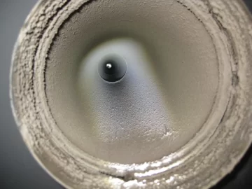

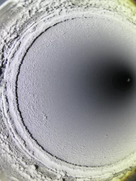

These?
This was mine after my very first year burning, where I had few cold starts. Back then I basically kept it lit 24/7 from start to finish. My how things have changed (for the better)! This was also before Lamppa supplied those two baffles inside the HX.

These?
No, it was a pic inside the HX...I don't remember the name anymore...seems to me he was from Indiana or Illinois
