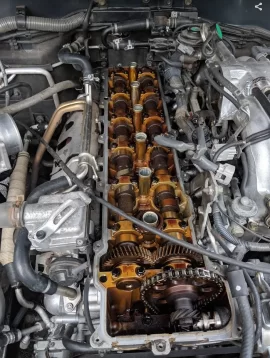

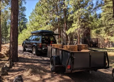

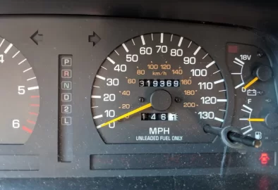

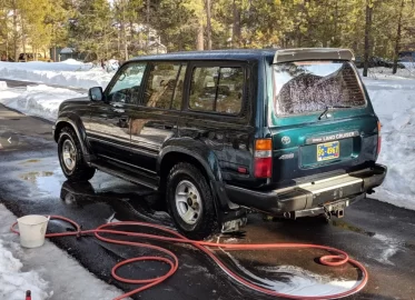

LOL at engine block replacement at 80k miles. The old 94' land cruiser is still on its original engine at 320k miles and doesn't skip a beat. Frequent oil changes and regular maintenance are key.... went on a 2500 mile road trip in July, had one issue, a burned out headlight bulb.
