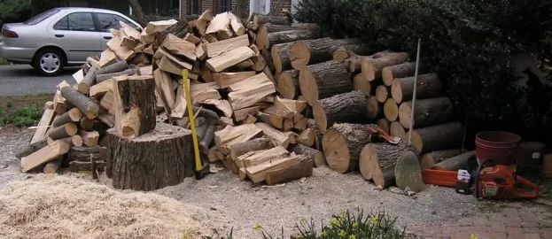

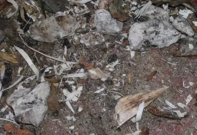

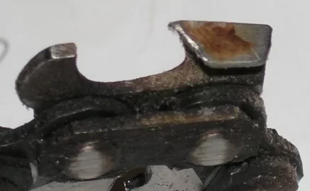

Spent the weekend getting started on my recent haul, a 32"-base red maple from a front yard a few blocks away. Used the saw to deal with the large and not-so-straight-grained pieces, hence the pile of wood shavings in the foreground. So I had the largest (and thus lowest) round up on edge, and was slicing it in half, when the chain goes completely dull. I didn't see any sparks, but there was some dirt coming out with the shavings, so I assumed I hit some sandy stuff. Swap chains, cut in a different area, then eventually I split the chunks. There was a narrow fissure going up through the middle with dirt and small roots in it, and I split that chunk along it. Out falls a handful of white landscape rock! >:( See the photos of the rock and what it did to the chain. You never know what you'll find in a yard tree, although it seems like a forest tree could find some rocks also...
Since I'm doing all this in my (short) driveway and it was decent weather, all my neighbors seemed like they walked by at some point to tell me that it seemed like a lot of work. I just tell them about my $50/month winter gas bill. I'm like the local mountain man or something. :lol:

Disco...You came across a "patch job tree". It's a little know thing that "old timers" used to "repair" a damaged tree. The old way of thinking...and it did work for the most part. If a tree had "cavities" or "soft spots" old timers would scrape/clean out the "hole" fill it with whatever they had (usually concrete) and over time the cambia layer would "envelope" around the patch instead of rolling around it. There is a tree in my neighborhood that a friend of mine (also another 'tree man') told me has BAGS worth of cement in it! We joke that if anyone goes to cut it down...we're going to break out the lawnchairs and a six-pack...and watch the comedy show!...lol Sucks you lost a chain or two...but now you know why tree guys/sawyers are leery about urban/"door yard" trees...they can "Be a treasure chest"...
If it was only a handful of rock, the stones might have been left by crows or ravens. We see all sorts of caches in the crotches of trees here, especially in the big maples. Sometimes there will be small bones, clam or crabshells in there too.

I expect I can save the chain on my cheapo HF grinder, it looked like that once before from sand. I'll run out of tooth pretty soon though. I've got a couple of dedicated "rock chains".
That rock didn't look like concrete, but like the standard white landscaping rock they sell in bags at Home Despot. People sometimes put that around trees like mulch, so I assumed somehow it got sucked up into the tree. The cavity would only have been maybe a foot off ground level.

Looking at your chain. You might be able to correct it with a machine sharpening, to be used as a backup .
All depends on how much has to be removed to sharpen it and how much is left.. I do like the shihl chains they cost a bit more but seem to last longer
and cut better
I've repaired that chain once before from similar damage, using a grinder, and I'll try it again. (I'm not very nice to chains.) Does anyone know how small it's OK to grind the teeth before it's time to toss it? Is the issue just the structural integrity of the tooth itself, or does the distance to the raker become too large? This chain, and another one I've reclaimed with the grinder, are sometimes a little jerky. I was wondering if that was due to the increased raker distance, or just some unevenness in the left/right tooth length (need to get some calipers) or something like that.
I'm not an expert, but I think you can basically sharpen it till there's no more tooth, or close to it. However you also need to file the rakers to the appropriate depth below the tooth, otherwise they keep the teeth from digging in... There is a guage you can get that drops over the tooth to protect it from the file and control how deep the rakers are, comes in various thicknesses, check the chain specs for which one you need.
Gooserider
Goose is right about filing them until there ain't nothing left to file--if you're filing them correctly.
As a matter of fact, in theory the chain should get sharper as it gets smaller.
There used to be a style of chain called "chipper" which had a rounded edge, as opposed to the more popular "chisel" and "semi-chisel" chains you usually find today. One thing the old chipper chain had going for it was that it stayed sharp a lot longer. A curved cutting "point" can take a lot more abuse than a sharp one, if you can picture what I'm trying to describe. Chipper chain wouldn't cut as fast as chisel chain, but it was actually better for typical firewood cutters, since they tend to get the chain into more dirt and obstacles than pros. Chipper chain is also less prone to kickback.
