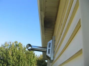

I have a direct vent Vermont Castings heater called Stardance. It uses gas logs.
Due to a problem it had, it released some soot above the vent outside. I will have the problem fixed.
However, I was wondering whether I could have a sort of hood placed above the vent so that if the soot problem ever happened again the soot would not go onto the siding.
I was thinking that if the hood was at an angle, tilting upward, the soot could be diverted away from the siding and soffit.
I'm including photos (below) so that you can see what I'm talking about.
Does anyone know whether such a hood exists?
Where could I go to find out?
What kind of technician deals with such a job?
Any feedback will be highly appreciated. I would like to solve this problem once the weather gets warmer.

The soot is PROBABLY coming from the ATF ratio. The air shutter needs to be opened more. More evidence of this condition will be sooty glass & logs. I don't see where a small aluminum diverter will hurt the operation of your unit. You'll need a siding guy (or your local hearthshop) to bend something that can be zipscrewed to the lip on the top of the vinyl siding stand-off...HTH

The soot will come right off. I've used Rutland "Speedy White" which is a stove (pyroceram) glass cleaner.
(broken link removed to http://ndlhearth.com/speedy-white.html)
Works really good on sooty gas deposits. IIRC that Vinyl Siding shield is 14" wide & the top lip stands out about 3". If you bent up a piece of aluminum that was full width with the first bend at 3" & maybe a 45 degree angle upwards, you'd be good to go. You may have to come out the full depth of the soffet, but being that high up I think aesthetically it wouldn't be a show stopper.

Back in May I decided to go with a plumber rather than a stove technician. He came, looked at my stove and vent on the outside of the building. He said that he needed $125 for the visit and would return in a week to adjust my stove (and would apply the $125 toward any work he did). He also asked to borrow my heater manual. However, he never returned. I called and left numerous messages with his answering service. To make a long story short, he finally came on Saturday (two days ago) after I threatened to file a complaint with the Massachusetts Board of State Examiners and Gas Fitters (someone gave me this suggestion). He changed my vent so that it now sticks out further from the wall (at no charge). But he did not make any adjustments to the air to fuel ratio. He also cleaned some of the soot that built up on the vinyl siding.
For the stove itself I plan to get someone who knows Vermont Castings to adjust the fuel to air ratio.
In the meantime, I just want to show you a photo of how the plumber changed the vent so that soot does not get onto the vinyl siding anymore. What do you think of his solution?

Somehow, the photo did not load up on my previous post. Here's a second attempt. You have to click on the photo to get a bigger view and actually see my vent.

that is quite odd.
never thought to do it that way!
i'd prefer to tighten up the venting, adjust air-fuel, derate the MB orifice, add a small sheetmetal diverter above the cap, etc.
i wouldn't let an inspector see it :)

2-i mean put a smaller main burner orifice in it- derating the capacity slightly can dramatically reduce sooting- especially in LPG models.
3a-no, at this point no sheetmetal diverter is needed
3b-the plumber was right, if he made a good connection, no soot should get on the siding. he was wrong however to modify the UL listed materials. He isn't a test lab or an engineer.

As long as the the Air-to-Fuel ratio is correct, there shouldn't be any sooting, but there are exceptions.
The makeshift vent configuration that your plumber came up with may cause additional problems. As Dave pointed out, your unit has not been tested to operate with this design.
