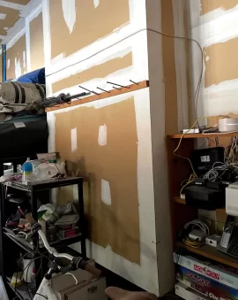

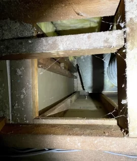

The good news is that it is installed in a wall that butts up against the garage, so the backside of the wall is a false wall encasing the ZC is totally accessible and not load bearing, so I can cut it and rebuild it rather easily, making it possible to remove the entire ZC fireplace from behind.

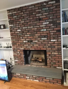

In case necessary, here are my existing dimensions:
Opening in the brick facade: 35.5" wide by 25" tall; hearth is elevated approximately 12" from the floor.

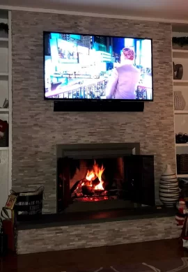

Existing FP depth (for a gas insert): 17" from the back of the insert to the backside of the brick facade, 30.75" from back of the insert to front of the facade. There is also additional 1" of stacked stone on top of the red brick, but it is somewhat easy to trim or add if needed. I've attached a picture of the fireplace before the stacked stone and after.
