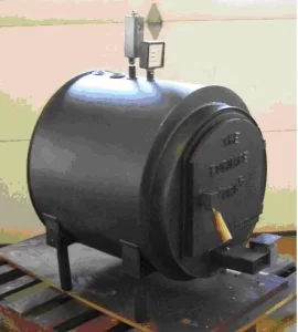

Myself I've heated with gasification with storage for 30 years and before that with conventional boiler without and with storage and creosote in the boiler and chimney is a major headache and hazard!
Reactions: flyingcow
Our first boiler and a long time ago, much like a OWB without the cute little house around it. Burned and belched 22 cords per year.

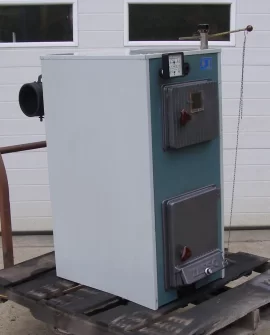

Our second, a triple pass downdrafting cast iron, burned 16 cords per year and that dropped to around 10 cords per year when 1,000 gallons of storage was added but could really creosote the chimney to the point where the only way to clean the chimney was to burn it clean twice a week, scary.
[Hearth.com] Suggestions on an OWB

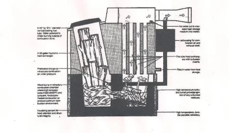

Our third boiler, a Jetstream with 1,000 gallons of storage and the same load, has burned around 4 1/2 cords per year for the last 30 years and the chimney almost never needs to be cleaned .
Our heating load is much like yours. In the winter we go an average of 40 hours between firings.
