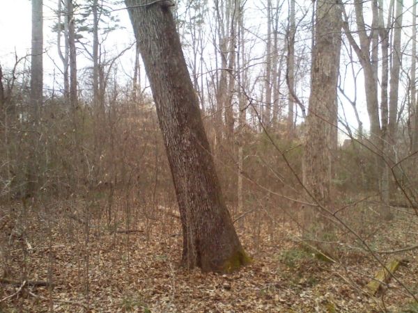

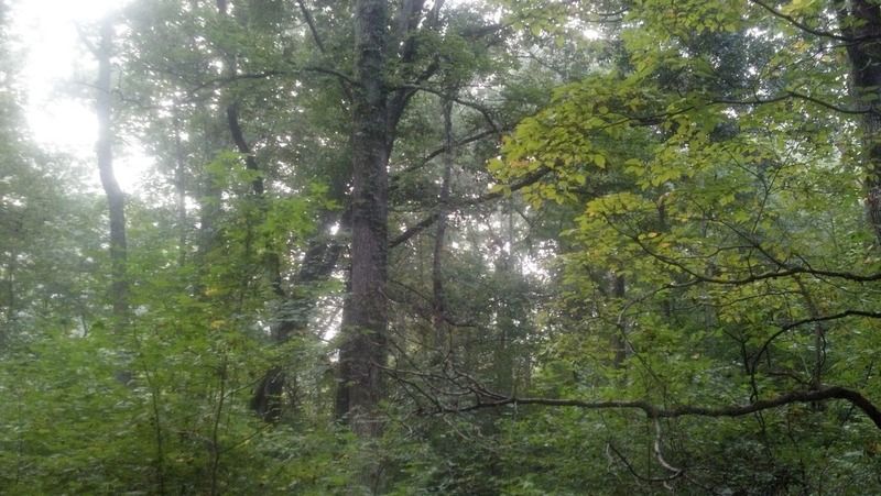

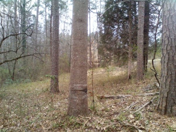

thanks for the suggestions. sorry, i couldn't get any pictures before it got too dark, but i did find a picture of the behemoth from last year. funny, it's leaning almost exactly as much as the one behind it in this picture that fell last year. i suppose with it, i could just let it go on its own terms. just curious, is tulip poplar more likely to barber chair than some others since it tends to not be stringy and splits easily?
ralphie boy... how well has your 455 done? i've been eyeballing them, and i don't cut more than about 3-4 cords a year, mostly oak, and some poplar.
anyway, here's the big'en, like mentioned, now is leaning like the one behind it was.

Big long rope , pull it down

How safe is it to leave now that it has been cut into? This is regarding the potential of life loss - kids, dogs, neighbors, freinds, tresspassers, etc... I would imagine you are dealing with monster liability issues with that hanging on to what is left. Beyond that, it now is weak and could fall in a direction you do not desire with strong wind creating a bigger mess. Personally I would get it on the ground if there is any method to do so carefully.

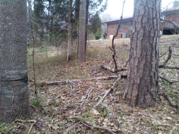

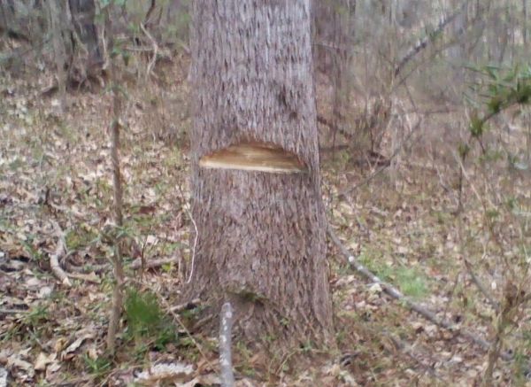

the aspect ratio seems to be off with this camera, because the face cut looks different (it's about 70 degrees, and 3 inches deep, and the house looks closer than it is, but it's about 100 feet away.

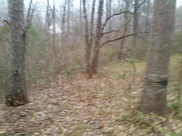

pine that's to the right from the front
[Hearth.com] suggestions on felling tree
pine that's to the left, and the lane i'm putting it through. it's about 20 feet, but like i mentioned, the aspect ratio looks off, and it's about 70 feet to that tree line

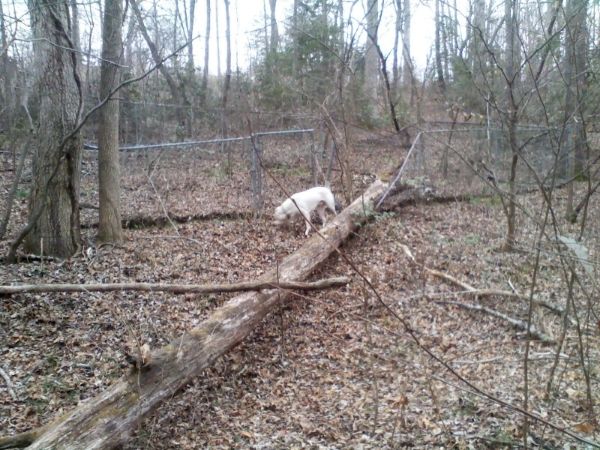

one of the widow makers i got down, and haven't cut up yet

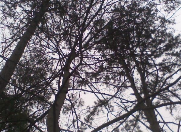

here's the top with the little tiny limbs somehow holding it in place

here's the big leaner, followed by a couple random pictures of some of the stuff that went down on their own with my sidekick magnus (dogo argentino) inspecting them. the fence was a dog lot from a previous owner that cared so much about their dogs that they kept them about a 1/4 mile from the house.

I'll say this much, I'd want those trees topped before I dropped them.....lots of snaggers and hangups in that little area....

I'm wondering why only 3" deep on the face? That would be good on a 9" diameter tree but that tree looks to be a bit larger. .

it's about 16" i was always under the impression that around 1/4" of the diameter for the face cut was sufficient and would give better accuracy for the drop point, so i went about 3" (it's a little more, but not quite 4") since i'm dropping it into that 20 foot lane. should i have gone with closer to a third anyway?
