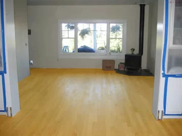

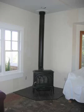

Your second option is exactly what I ended up doing. I was way too busy with a full time job and getting our house back together after a foundation job to consider building a hearth pad. So I got a nice premade unit and put it on the subfloor, then had the oak flooring built to surround it. The end job finished out pretty nicely. Here are before and after pics showing the pad on the subflooring.

BeGreen, thanks for including the pictures of your premade hearthpad with the flooring around it. At this point, this might be our simplest option.
