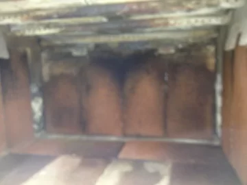

Pulled out the Regency today to clean up everything. Removed all the firebricks and checked everywhere for cracks.
[Hearth.com] Summer Cleaning and insulating my Regency i2400
Found nothing, but did see what my original installer considered a "Mantle plate". What is this stuff? It feels like cotton balls glued to aluminum foil.

It looks like they loosely shoved some foil backed fiberglass up there. Your work looks more professional. Definitely don't wash the firebrick. It will absorb the water like a sponge and may take quite a while to fully dry out. Trapped moisture + rapid heating is likely to = cracked brick.

1) The original foil thing that was in there was very thick foil. I pushed it up and creased it over the flue opening to make it as tight as possible. That is the "block off plate" now. Probably not as good as a metal one, but the flow of air I felt was greatly reduced. I admit, there was still a small amount of airflow.
