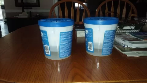

i cover my OAK vent with duct tape and put 2 cans of damprid in the stove.
1 in the firebox, 1 in the ashpan. the pix below shows approx 4" of water collected over the spring/ summer..
this was before i started sealing off the exhaust top with the freezer bag.
i also spray the inside firebox walls with pam cooking spray.. [un-flavored of course]...

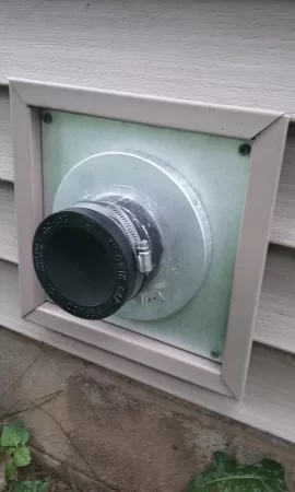

First I do a deep clean.
I take the outer pieces of the pipe off the outside of the house and slap a Fernco cap on (as shown). My pipe is 3 inch, so I bought a 3" Fernco cap at Lowe's (it cost less than $5.00). Once you loosen the clamp up it slips on and is a snug, watertight fit.
I spray cooking spray on the burn pot (recommended by someone here).
I put the small container of damp rid down in the bottom of my ash pan (again recommended by someone here), and shut all the doors tight.
Then I unplug everything and walk away until October. Well... sort of. Once in a while I check the damp rid to see if it's getting filled up (it never is).
