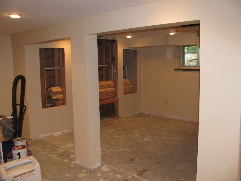

Here's what it looks after relocating and enclosing duct work, adding recessed lighting, and sheetrock:
[Hearth.com] Summer project-finishing the basement

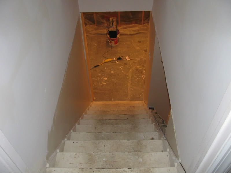

A little progress:

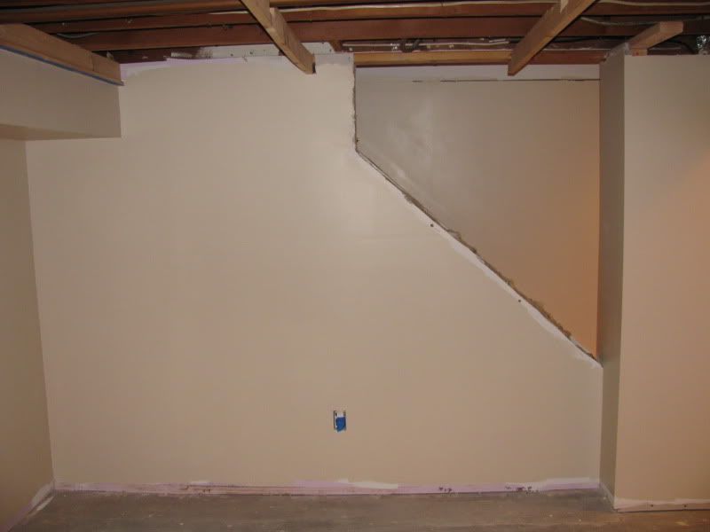

The walls on either side of the steps used to have pegboard for holding pots and pans and housecleaning stuff. That's all going to be stored elsewhere now.
Looks much better after a little spackle and paint:

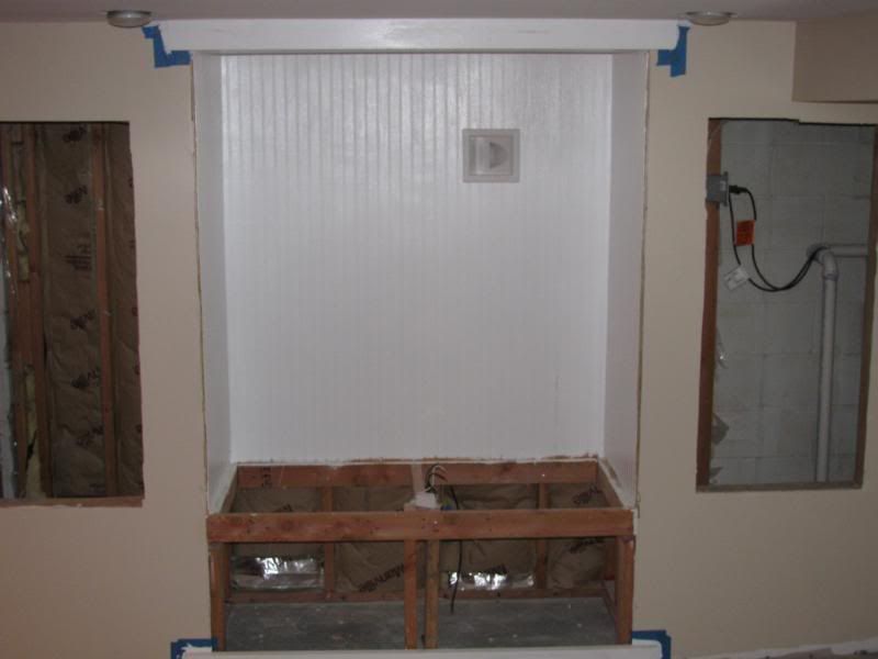

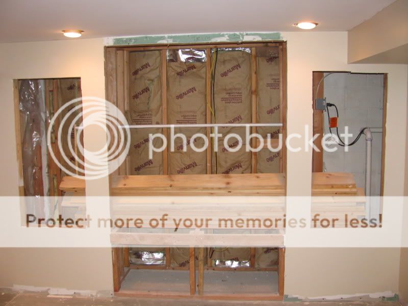

The built in entertainment center-what's not covered with drywall will be faced with beadboard. The two openings on either side will house bookshelves that can be pulled out if need be. On the right is one of the sump pumps, so access will be needed there periodically. On the right I was thinking of installing a safe at some point:

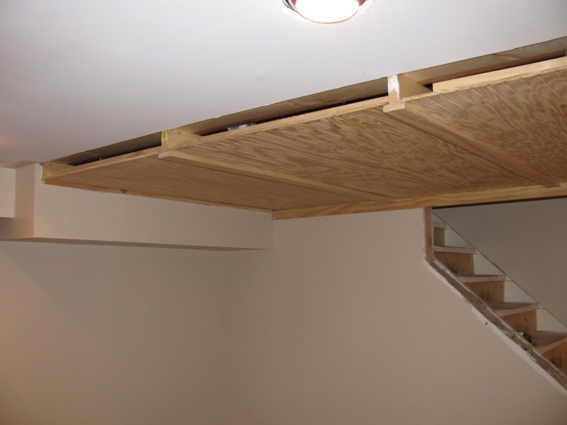

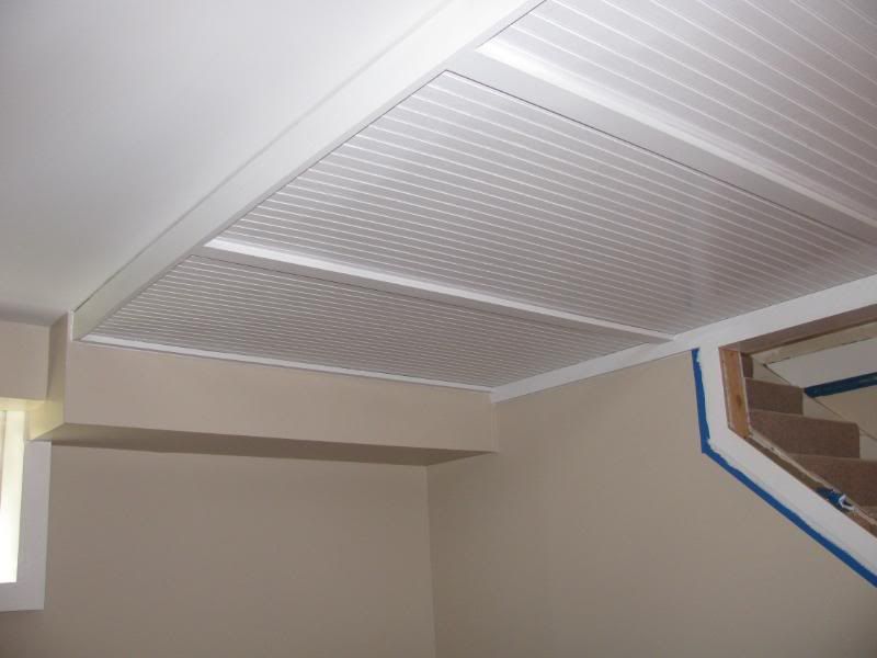

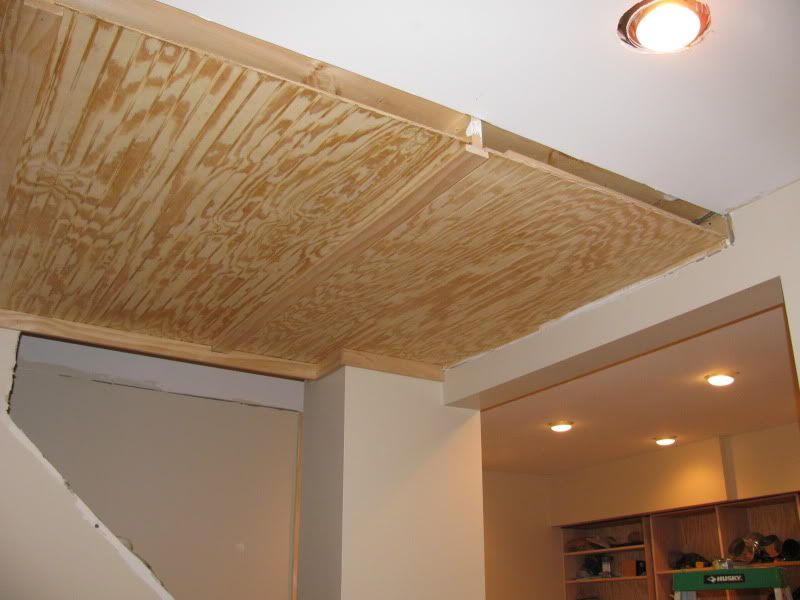

And now for today's work-the beadboard panel ceiling. I had to drop the ceiling a bit because this area is right below the kitchen and the drain line hangs below the floor joists. I figured it would be a lot easier if I did some sort of panelized ceiling so that if something needs to be accessed, it's a matter of pulling a few nails and sliding the panels out rather than ripping up drywall. It's coming out even better than I thought it would. The panels are Georgia Pacific faux beadboard-I nailed some braces to the back to stiffen them which seems to work well. The panels just slide in through the front which will be faced with 1x lumber. Everything will be painted semi-gloss white:
We ordered carpet last Friday-hopefully it will be installed this coming Saturday, which is just as well, I need to get one more coat of white on the ceiling and it's nice not having to worry about drips on the floor.
I like the ceiling panel solution. I have kind of the same situation. I might steal you idea.
looking good thanks for the pics.
Same here. Consider it stolen, but slightly tweaked.
I'll probably make some dado cuts in some boards, fasten the board to the joists (running in the same direction as the joists), rip down the panelling to fit, and make some "drawers" to access my kitchen plumbing above my bathroom in the basement. Trim the ends with some 1x and voila....ceiling problem solved. It will kinda look like a board and baton ceiling.
I never would have thought of that if I didn't see your post. Thanks!

There's still a little more trim to do but the beadboard ceiling is coming out nice:

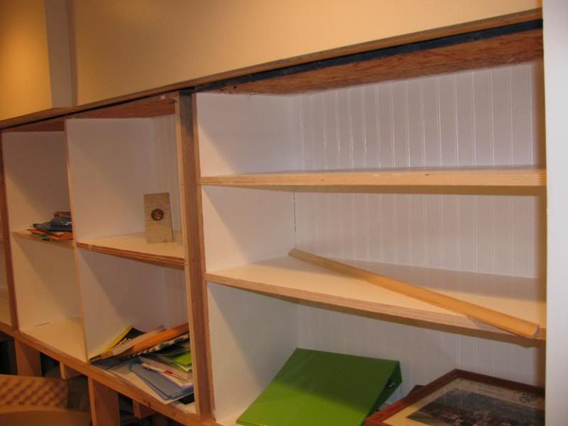

These are the built in bookshelves-they still need a lot of trim work:

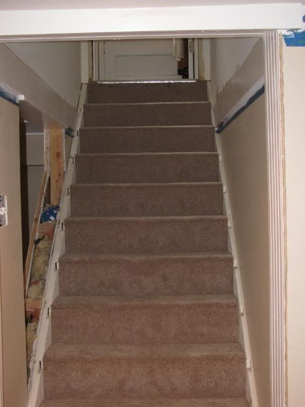

The stairs sure look different-I have to find a new way to bring wood into the house now-tromping through the mud to the woodshed and down the steps is out of the question:

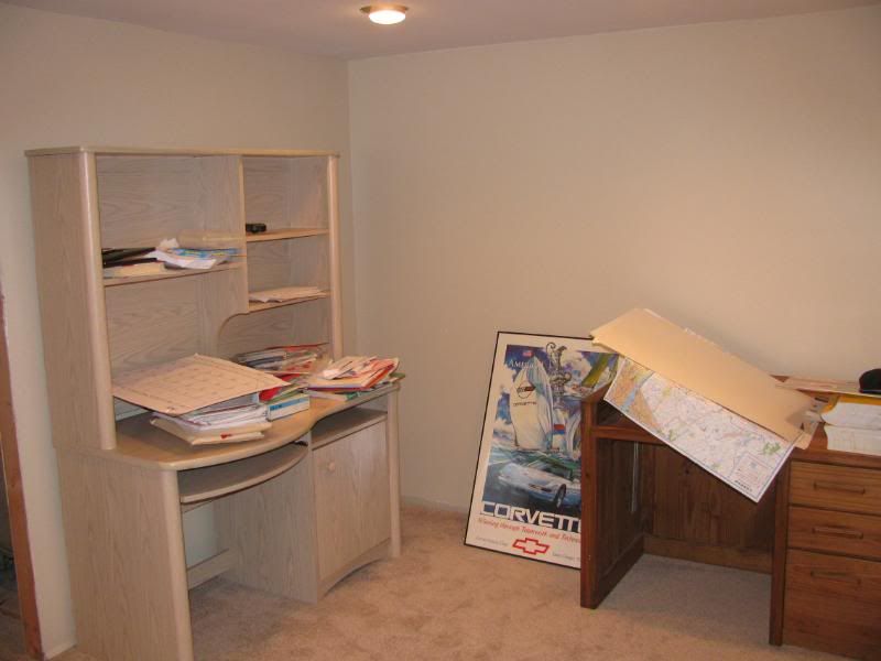

The "office" area:
