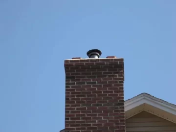

Ok!maybe a far fetch problem but ill ask.Has anyone had any problems with bees making nests or entering the house threw the chimney?Where i live we have a problem with hornets and yellow jackets getting into everything.Before we put in the wood stove this year the fireplace damper would always be closed preventing any outside entry.With a wood stove there still may be entry into the stove with the stove damper closed.When the installer placed the ss top cover!he cut larger holes into it saying it was to help prevent creosote build up there.Big enough holes for bees and not small animals to enter.

He cut holes in the top plate on top of the chimney? That is supposed to be totally sealed off to prevent air from flowing down the old chimney into the house. Unless there is a sealed block off plate?
I see in your signature you do have a block off plate. Still doesn't make any sense to cut holes in the top plate.
jtp is correct, the top plate should be a weathertight seal, no holes at all there. Do you mean he cut holes in the top chimney plate or he drilled holes in the top of the flue cap? If they are in the flue cap, I don't get the reasoning behind this.

[quote author="BeGreen" date="1208634150"]jtp is correct, the top plate should be a weathertight seal, no holes at all there. Do you mean he cut holes in the top chimney plate or he drilled holes in the top of the flue cap? If they are in the flue cap, I don't get the reasoning behind this.[/quote
The slots under the rain cap were made larger!When i saw installer doing this i asked him why and he said to help prevent creosote buildup and possible loss of air flow.Top plate is sealed.Heres a pic! Click on to enlarge

I have never had to modify one single cap and don't plan on it. They are engineered pieces of equipment.
No offense but that cap you have looks pretty pitiful.

No Offense Taken!Im still a rookie who will know more in time.I can always get a new cap.
