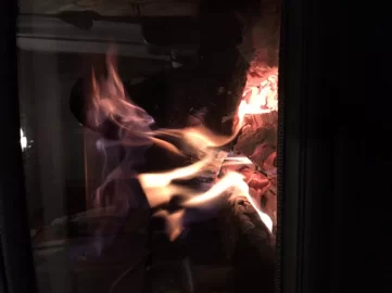

Here’s a pic of fire I built tonight after I removed the room air cover it burned a lot better.
  • [Hearth.com] Summit first burn
Reactions: Highbeam

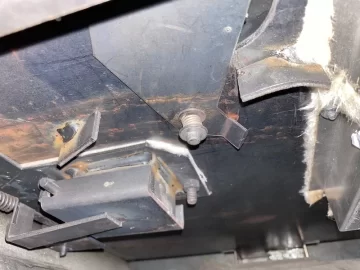

Are there any adjustments to the EBT or primary air, I set the damper on high after reloading and went back to shut it down and it had moved at least 1/2 “ by itself
No adjustment to the EBT. By damper, do you mean the air control. That is a friction fit. Odd that it would move on it's own. Is it exceptionally loose and sloppy or does it present some resistance when changing the setting?
Yes the air control and it’s really easy to move no resistance at all really. It has 3 marked settings , start , high and low. Start and high are the same unless mines not moving right.
Ok, the fix is easy. Remove the ash pan. Take a flashlight and peek under there, following the air control lever back to its pivot point. There is a spring-loaded screw at the pivot point. Give it a turn tighter to increase the tension. I think you can do this by hand.
