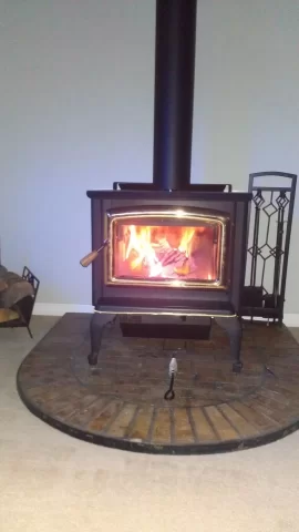

The splits are about 4 to 6 inches wide long enough I could not them load east west. It was rainy and little windy. I noticed if I loaded the stove east west I could get a little longer burn but I am not seeing 4 hour burns. Here is a pic with damper being shut down. I was also able to start of fire last week when I accidentally left the damper closed without any problems [Hearth.com] Super 27 burning wood to fast

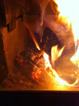

Welcome to the forum Mr3117. I did almost exactly what you did. Im at work but my wife just loaded the stove and took this picture for us. You can see a piece of wood on the bottom left of her picture? That's whats left over from a split of lodgepole that I put in 4 hours ago. I put in 3 decent sized splits of Lodgepole around 9:30 or 10:00. The stove top was cooling off but the wood was put on a good bed of coals raked forward and caught almost right away. I turned down the stove in increments and after reaching 650 stove top it steadied down to the mid 500s. Had I put another three in there I think it would have lasted longer. I question how you registered the 200 degrees? My numbers are in F and are taken from the center of the stove near the stove pipe collar with an infra red.

I have a condar inferno stove top thermometer that read 200. That piece you have left over from your 4 burn is what I might have after 2 hours if im lucky
