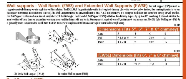

EXCEL Chimney See (broken link removed to http://www.icc-rsf.com/en/icc/Insulated_Stainless_Steel_Chimney).
I have the same problem at to I did not want ot go through the soffit nor did I want to use elbows. I have decided to use the ICC Excel chimney as it has allowed to extend away from the house enough to bypass the soffit and extend the chimney straight up.

  • [Hearth.com] Supervent pipe 45* fittings
