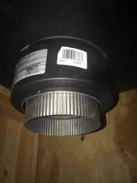

I have sourced Selkirk class A chimney pipe and installed the chimney components with an Excel metal roof flashing (thanks for the recommendation begreen). The issue I am having is connecting the support box to Security Secure Black Double Wall pipe. I have the chimney pipe adapter from Selkirk that fits inside the double wall but the ring on the support box doesn't want to fit outside or inside the male end of security stove pipe. In a perfect world it would be a proprietary system but I have hopes of making this work with a few re purposed components.
Please see attached photo of the support package. The security double wall drops down to a "T" and enters the rear of the stove. It is possible to use the female end of the stove pipe, wrapping around the support ring. This would be against the mating orientation specified by security. It would also pose the issue of closing off the male end of the "T" at the bottom of the stack. I have entertained a support band of some sort but have some concerns. Thank you in advance for any thoughts or suggestions.
