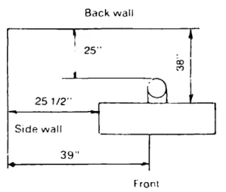

I found a pdf of the manual and it says to install the back of the stove 17” from a combustible surface. If I covered my wall with a non combustible surface could I install it closer?

Re-read the manual. This stove has high clearances. The rear clearance is 38" from the stove, 25" from the connector pipe. Side clearance is 25.5" The clearance can be reduced to no less than 12" with a proper ventilated wall shield. This can be made out of metal, cement board (tiled or not) or other rigid non-combustible material set on 1" spacers and open at the bottom and top. (The 17" from the rear of the stove is for the hearth protection. The diagram on the right is the clearances diagram.)

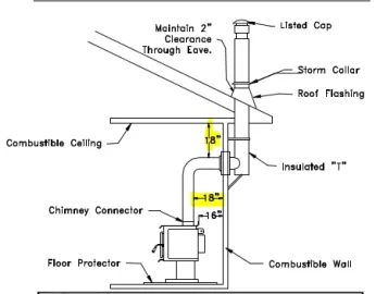

Note that the connecting stove pipe also has a clearance requirement. Single wall requires 18" unless shielded. Double-wall stove pipe typically has a clearance of 6".

Metal chimney pipe requires at least 2" clearance from combustibles. The brackets made for the chimney pipe provide this clearance.
• If we install a double wall insulated pipe chimney do we also need to get a liner? When searching for chimney pipe I keep coming across a flexi liner thing.
What you need is class A chimney pipe. No liner, that is for an existing masonry chimney. You will also need a proper thimble to pass a short stub of chimney pipe through the wall that ties in to a tee at the bottom of the chimney.
