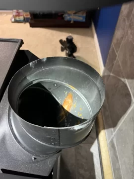

We replaced our Vermont Castings with a Jotul F35. The stove was installed yesterday by a dealer who does their own installations.
I was reading through the manual and saw this statement in all caps: “Connecting double wall pipe to a single wall adapter will violate safety compliance.” This is repeated elsewhere.
I didn’t see the installer take a separate part from his van, so I pulled up the chimney connector today to verify that the elbow was double wall. It sure does not look like it, but I’m not an expert (which is why we hired someone) and would like to have someone confirm before I call the company.

Single wall pipe has different clearance requirements. It needs 18" clearance from combustibles. If that clearance is honored, then using a single-wall piece to adapt is not unheard of. Some stoves have flue collars that are hard to connect to and sometimes the double-wall adapter does not mate snugly. In those cases the installer may have to improvise. However, this needs to be done safely and securely.
Also, that elbow should be stainless. It it's painted galvanized, I would be less than satisfied.

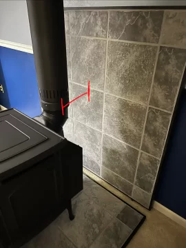

@begreen, it is 11-1/2" from the centerline of the chimney connector to the wall board and 2-7/8" from front of the wall board to the wall. Not sure if that helps.
As for the material, it was whatever elbow came with the stove. I'm 90 percent certain about that.

If the wall board is set up to be a proper NFPA 211 shield, ie: non-combustible and on 1" spacers, and open at the top and bottom by an inch, then it is safe. Security does make a 45º double-wall elbow but I am not sure their double-wall stove adapter would work here.
Reactions: manofstihl
That is an American Panel Hearth Products Wall Board that complies with NFPA 211, and it is mounted on brackets 1” off the floor and out from the wall.
That explains it, then. Thanks, @begreen.
