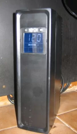

I used to use an inexpensive Radio Shack on my Astoria that had surprising ratings for it's cost, but since i have a new stove with more electronics, I have since upgraded to this:
Tripp Lite Smart 1000LCD. its a surge protector and UPS. Should last 8-10 minutes w/ stove, and also corrects for brown-outs, and line surges:
SURGE / NOISE SUPPRESSION
UPS AC suppression joule rating-1038 joules
EMI / RFI AC noise suppression-Yes
AC suppression response time-Instantaneous
Transfer time from line power to battery mode..2-4 milliseconds
Low voltage transfer to battery power-Switches to battery power as line voltage decreases to 89V or less, switches back to AC
mode as line voltage increases to 94V or higher
High voltage transfer to battery power - Switches to battery mode as line voltage increases to 139V or higher, switches back to
AC mode as line voltage decreases to 135V or lower
Voltage regulation-Line-interactive voltage regulation corrects brownouts as low as 89V back to safe values
Brownout correction-Brownouts as low as 89V are boosted by 14%
