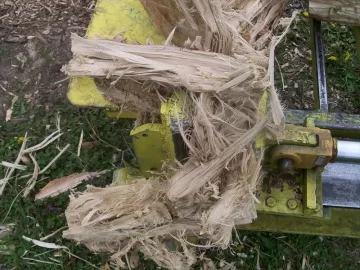

And a 22 ton unit would have barfed on this log:

Actually - I am not sure that my splitter didn't.;lol
Sorry for the repeat posting of that pic. I am sure some of you long timers are getting tired of it.
That pic alone should scare us all off of Elm.
kinda looks like he ran that piece through a Morbark chipper!!
[Hearth.com] Surprise!
Believe it or not, I split some ash a week ago that looked like that. Worst ash I've ever split.....
I think I'd rather burn $5.00/gallon propane than deal with Elm. Garbage wood in my opinion.
Oh yea they dry fast and well but the splitter has to basically cut/rip through them. Some I had were so springy I had to cut them the rest of the way with an axe or the saw! That's off a hydro splitter!
